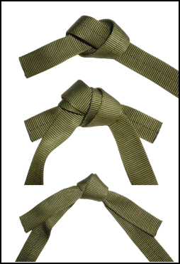

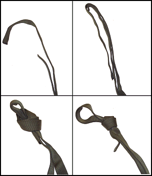

Water Knot
The water knot is used to attach two webbing ends (Figure 4-10). It is also called a ring bend, overhand retrace, or tape knot. It is used in runners and harnesses and is a joining knot.
a. Tying the Knot.
STEP 1. Tie an overhand knot in one of the ends.
STEP 2. Feed the other end back through the knot, following the path of the first rope in reverse.
STEP 3. Draw tight and pull all of the slack out of the knot. The remaining tails must extend at least 4 inches beyond the knot in both directions.
Figure 4-10. Water knot.
b. Checkpoints.
(1) There are two overhand knots, one retracing the other.
(2) There is no slack in the knot, and the working ends come out of the knot in opposite directions.
(3) There is a minimum 4-inch pigtail.

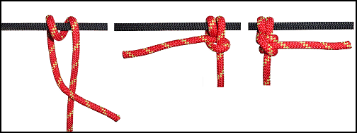

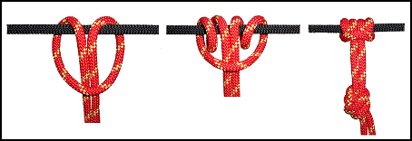

Clove Hitch
The clove hitch is an anchor knot that can be used in the middle of the rope as well as at the end (Figure 4-14). The knot must have constant tension on it once tied to prevent slipping. It can be used as either an anchor or middle of the rope knot, depending on how it is tied.
a. Tying the Knot.
(1) Middle of the Rope.
STEP 1. Hold rope in both hands, palms down with hands together. Slide the left hand to the left from 20 to 25 centimeters.
STEP 2. Form a loop away from and back toward the right.
STEP 3. Slide the right hand from 20 to 25 centimeters to the right. Form a loop inward and back to the left hand.
STEP 4. Place the left loop on top of the right loop. Place both loops over the anchor and pull both ends of the rope in opposite directions. The knot is tied.
(2) End of the Rope.
Note: For instructional purposes, assume that the anchor is horizontal.
STEP 1. Place 76 centimeters of rope over the top of the anchor. Hold the standing end in the left hand. With the right hand, reach under the horizontal anchor, grasp the working end, and bring it inward.
STEP 2. Place the working end of the rope over the standing end (to form a loop). Hold the loop in the left hand. Place the working end over the anchor from 20 to 25 centimeters to the left of the loop.
STEP 3. With the right hand, reach down to the left hand side of the loop under the anchor. Grasp the working end of the rope. Bring the working end up and outward.
STEP 4. Dress down the knot.
Figure 4-14. Clove hitch.
b. Checkpoints.
(1) The knot has two round turns around the anchor with a diagonal locking bar.
(2) The locking bar is facing 90 degrees from the direction of pull.
(3) The ends exit l80 degrees from each other.
(4) The knot has more than a 4-inch pigtail remaining.

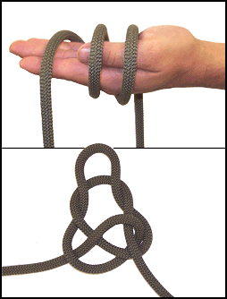

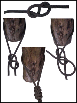

Wireman's Knot
The wireman’s knot forms a single, fixed loop in the middle of the rope (Figure 4-15). It is a middle rope knot.
a. Tying the Knot.
STEP 1. When tying this knot, face the anchor that the tie-off system will be tied to. Take up the slack from the anchor, and wrap two turns around the left hand (palm up) from left to right.
STEP 2. A loop of 30 centimeters is taken up in the second round turn to create the fixed loop of the knot.
STEP 3. Name the wraps from the palm to the fingertips: heel, palm, and fingertip.
STEP 4. Secure the palm wrap with the right thumb and forefinger, and place it over the heel wrap.
STEP 5. Secure the heel wrap and place it over the fingertip wrap.
STEP 6. Secure the fingertip wrap and place it over the palm wrap.
STEP 7. Secure the palm wrap and pull up to form a fixed loop.
STEP 8. Dress the knot down by pulling on the fixed loop and the two working ends.
STEP 9. Pull the working ends apart to finish the knot.
Figure 4-15. Wireman's knot.
Figure 4-15. Wireman’s knot.
b. Checkpoints.
(1) The completed knot should have four separate bights locking down on themselves with the fixed loop exiting from the top of the knot and laying toward the near side anchor point.
(2) Both ends should exit opposite each other without any bends.

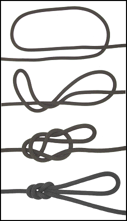

Directional Figure-Eight
The directional figure-eight knot forms a single, fixed loop in the middle of the rope that lays back along the standing part of the rope (Figure 4-16). It is a middle rope knot.
a. Tying the Knot.
STEP 1. Face the far side anchor so that when the knot is tied, it lays inward.
STEP 2. Lay the rope from the far side anchor over the left palm. Make one wrap around the palm.
STEP 3. With the wrap thus formed, tie a figure-eight knot around the standing part that leads to the far side anchor.
STEP 4. When dressing the knot down, the tail and the bight must be together.
Figure 4-16. Directional figure-eight.
b. Checkpoints.
(1) The loop should be large enough to accept a carabiner but no larger than a helmet-size loop.
(2) The tail and bight must be together.
(3) The figure eight is tied tightly.
(4) The bight in the knot faces back toward the near side.

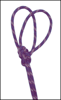

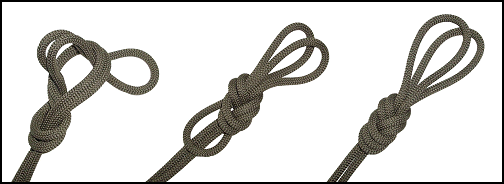

Bowline-On-A-Bight (Two-Loop Bowline)
The bowline-on-a-bight is used to form two fixed loops in the middle of a rope (Figure 4-17). It is a middle rope knot.
a. Tying the Knot.
STEP 1. Form a bight in the rope about twice as long as the finished loops will be.
STEP 2. Tie an overhand knot on a bight.
STEP 3. Hold the overhand knot in the left hand so that the bight is running down and outward.
STEP 4. Grasp the bight with the right hand; fold it back over the overhand knot so that the overhand knot goes through the bight.
STEP 5. From the end (apex) of the bight, follow the bight back to where it forms the cross in the overhand knot. Grasp the two ropes that run down and outward and pull up, forming two loops.
STEP 6. Pull the two ropes out of the overhand knot and dress the knot down.
STEP 7. A final dress is required: grasp the ends of the two fixed loops and pull, spreading them apart to ensure the loops do not slip.
Figure 4-17. Bowline-on-a-bight.
b. Checkpoints.
(1) There are two fixed loops that will not slip.
(2) There are no twists in the knot.
(3) A double loop is held in place by a bight.
Two-Loop Figure-Eight
The two-loop figure-eight is used to form two fixed loops in the middle of a rope (Figure 4-18.) It is a middle rope knot.
a. Tying the Knot.
STEP 1. Using a doubled rope, form an 18-inch bight in the left hand with the running end facing to the left.
STEP 2. Grasp the bight with the right hand and make a 360-degree turn around the standing end in a counterclockwise direction.
STEP 3. With the working end, form another bight and place that bight through the loop just formed in the left hand.
STEP 4. Hold the bight with the left hand, and place the original bight (moving toward the left hand) over the knot.

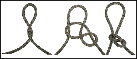

Figure-Eight Loop (Figure-Eight-On-A-Bight)
The figure-eight loop, also called the figure-eight-on-a-bight, is used to form a fixed loop in a rope (Figure 4-19). It is a middle of the rope knot.
a. Tying the Knot.
STEP 1. Form a bight in the rope about as large as the diameter of the desired loop.
STEP 2. With the bight as the working end, form a loop in rope (standing part).
STEP 3. Wrap the working end around the standing part 360 degrees and feed the working end through the loop. Dress the knot tightly.
Figure 4-19. Figure-eight loop.
b. Checkpoints.
(1) The loop is the desired size.
(2) The ropes in the loop are parallel and do not cross over each other.
(3) The knot is tightly dressed.
Prusik Knot
The Prusik knot is used to put a moveable rope on a fixed rope such as a Prusik ascent or a tightening system. This knot can be tied as a middle or end of the rope Prusik. It is a specialty knot.
a. Tying the Knot.
(1) Middle-of-the-Rope Prusik. The middle-of-the-rope Prusik knot can be tied with a short rope to a long rope as follows (Figure 4-20.):
STEP 1. Double the short rope, forming a bight, with the working ends even. Lay it over the long rope so that the closed end of the bight is 12 inches below the long rope and the remaining part of the rope (working ends) is the closest to the climber; spread the working end apart.
STEP 2. Reach down through the 12-inch bight. Pull up both of the working ends and lay them over the long rope. Repeat this process making sure that the working ends pass in the middle of the first two wraps. Now there are four wraps and a locking bar working across them on the long rope.
STEP 3. Dress the wraps and locking bar down to ensure they are tight and not twisted. Tying an overhand knot with both ropes will prevent the knot from slipping during periods of variable tension.
Figure 4-20. Middle-of-the-rope Prusik.
(2) End-of-the-Rope Prusik (Figure 4-21).
STEP 1. Using an arm’s length of rope, and place it over the long rope.
STEP 2. Form a complete round turn in the rope.
STEP 3. Cross over the standing part of the short rope with the working end of the short rope.
STEP 4. Lay the working end under the long rope.
STEP 5. Form a complete round turn in the rope, working back toward the middle of the knot.
STEP 6. There are four wraps and a locking bar running across them on the long rope. Dress the wraps and locking bar down. Ensure they are tight, parallel, and not twisted.
STEP 7. Finish the knot with a bowline to ensure that the Prusik knot will not slip out during periods of varying tension.
Figure 4-21. End-of-the-rope Prusik knot.
b. Checkpoints.
(1) Four wraps with a locking bar.
(2) The locking bar faces the climber.
(3) The knot is tight and dressed down with no ropes twisted or crossed.
(4) Other than a finger Prusik, the knot should contain an overhand or bowline to prevent slipping.
Bachman Knot
The Bachman knot provides a means of using a makeshift mechanized ascender (Figure 4-22). It is a specialty knot.
a. Tying the Knot.
STEP 1. Find the middle of a utility rope and insert it into a carabiner.
STEP 2. Place the carabiner and utility rope next to a long climbing rope.
STEP 3. With the two ropes parallel from the carabiner, make two or more wraps around the climbing rope and through the inside portion of the carabiner.
Note: The rope can be tied into an etrier (stirrup) and used as a Prusik-friction principle ascender.
b. Checkpoints.
(1) The bight of the climbing rope is at the top of the carabiner.
(2) The two ropes run parallel without twisting or crossing.
(3) Two or more wraps are made around the long climbing rope and through the inside portion of the carabiner.
Figure 4-22. Bachman knot.

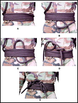

Bowline-On-A-Coil
The bowline-on-a-coil is an expedient tie-in used by climbers when a climbing harness is not available (Figure 4-23). It is a specialty knot.
a. Tying the Knot.
STEP 1. With the running end, place 3 feet of rope over your right shoulder. The running end is to the back of the body.
STEP 2. Starting at the bottom of your rib cage, wrap the standing part of the rope around your body and down in a clockwise direction four to eight times.
STEP 3. With the standing portion of the rope in your left hand, make a clockwise loop toward the body. The standing portion is on the bottom.
STEP 4. Ensuring the loop does not come uncrossed, bring it up and under the coils between the rope and your body.
STEP 5. Using the standing part, bring a bight up through the loop. Grasp the running end of the rope with the right hand. Pass it through the bight from right to left and back on itself.
STEP 6. Holding the bight loosely, dress the knot down by pulling on the standing end.
STEP 7. Safety the bowline with an overhand around the top, single coil. Then, tie an overhand around all coils, leaving a minimum 4-inch pigtail.
b. Checkpoints.
(1) A minimum of four wraps, not crossed, with a bight held in place by a loop.
(2) The loop must be underneath all wraps.
(3) A minimum 4-inch pigtail after the second overhand safety is tied.
(4) Must be centered on the mid-line of the body.
Figure 4-23. Bowline-on-a-coil.
Three-Loop Bowline
The three-loop bowline is used to form three fixed loops in the middle of a rope (Figure 4-24). It is used in a self-equalizing anchor system. It is a specialty knot.
a. Tying the Knot.
STEP 1. Form an approximate 24-inch bight.
STEP 2. With the right thumb facing toward the body, form a doubled loop in the standing part by turning the wrist clockwise. Lay the loops to the right.
STEP 3. With the right hand, reach down through the loops and pull up a doubled bight from the standing part of the rope.
STEP 4. Place the running end (bight) of the rope (on the left) through the doubled bight from left to right and bring it back on itself. Hold the running end loosely and dress the knot down by pulling on the standing parts.
STEP 5. Safety it off with a doubled overhand knot.
Figure 4-24. Three-loop bowline.
b. Checkpoints.
(1) There are two bights held in place by two loops.
(2) The bights form locking bars around the standing parts.
(3) The running end (bight) must be on the inside of the fixed loops.
(4) There is a minimum 4-inch pigtail after the double overhand safety knot is tied.

Transport Knot (Overhand Slip Knot/Mule Knot)
The transport knot is used to secure the transport tightening system (Figure 4-26). It is simply an overhand slip knot.
a. Tying the Knot.
STEP 1. Pass the running end of the rope around the anchor point passing it back under the standing portion (leading to the far side anchor) forming a loop.
STEP 2. Form a bight with the running end of the rope. Pass over the standing portion and down through the loop and dress it down toward the anchor point.
STEP 3. Secure the knot by tying a half hitch around the standing portion with the bight.
Figure 4-26. Transport knot.
b. Check Points.
(1) There is a single overhand slip knot.
(2) The knot is secured using a half hitch on a bight.
(3) The bight is a minimum of 12 inches long.

Frost Knot
The frost knot is used when working with webbing (Figure 4-28). It is used to create the top loop of an etrier. It is a special-purpose knot.
a. Tying the Knot.
STEP 1. Lap one end (a bight) of webbing over the other about 10 to 12 inches.
STEP 2. Tie an overhand knot with the newly formed triple-strand webbing; dress tightly.
Figure 4-28. Frost knot.
b. Checkpoints.
(1) The tails of the webbing run in opposite directions.
(2) Three strands of webbing are formed into a tight overhand knot.
(3) There is a bight and tail exiting the top of the overhand knot.

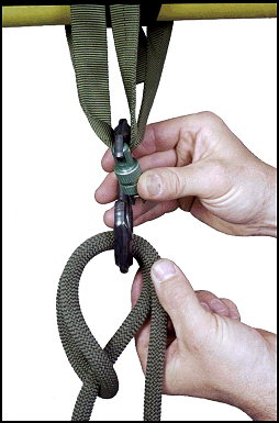

Munter Hitch
The munter hitch, when used in conjunction with a pear-shaped locking carabiner, is used to form a mechanical belay (Figure 4-30).
a. Tying the Knot.
STEP 1. Hold the rope in both hands, palms down about 12 inches apart.
STEP 2. With the right hand, form a loop away from the body toward the left hand. Hold the loop with the left hand.
STEP 3. With the right hand, place the rope that comes from the bottom of the loop over the top of the loop.
STEP 4. Place the bight that has just been formed around the rope into the pear shaped carabiner. Lock the locking mechanism.
b. Check Points.
(1) A bight passes through the carabiner, with the closed end around the standing or running part of the rope.
(2) The carabiner is locked.
Figure 4-30. Munter hitch.
