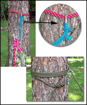

e. The rope the can be secured using one of three methods: transport knot (Figure 7-11), round turn around anchor and two half hitches on a bight (Figure 7-12), or a tensionless anchor knot (Figure 7-13).
Figure 7-11. Transport knot
Figure 7-12. Round turn around anchor and two half hitches on a bight.
Figure 7-13. Tensionless anchor knot.
