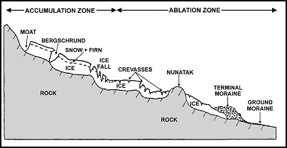

    Figure 10-21. Glacier cross section.
    Figure 10-22. Glacier features.
    (1) Firn is compacted granular snow that has been on the glacier at least one year. Firn is the building blocks of the ice that makes the glacier.
    (2) The accumulation zone is the area that remains snow-covered throughout the year because of year-round snowfall. The snowfall exceeds melt.
    (3) The ablation zone is the area where the snow melts off the ice in summer. Melt equals or exceeds snowfall.
    (4) The firn line separates the accumulation and ablation zones. As you approach this area, you may see "strips" of snow in the ice. Be cautious, as these could be snow bridges remaining over crevasses. Remember that snow bridges will be weakest lower on the glacier as you enter the accumulation zone. The firn line can change annually.
    (5) A bergschrund is a large crevasse at the head of a glacier caused by separation of active (flowing) and inactive (stationary) ice. These will usually be seen at the base of a major incline and can make an ascent on that area difficult.
    (6) A moat is a wall formed at the head (start) of the glacier. These are formed by heat reflected from valley wall.
    (7) A crevasse is a split or crack in the glacier surface. These are formed when the glacier moves over an irregularity in the bed surface.
    (8) A transverse crevasse forms perpendicular to the flow of a glacier. These are normally found where a glacier flows over a slope with a gradient change of 30 degrees or more.
    (9) Longitudinal crevasses form parallel to the flow of a glacier. These are normally found where a glacier widens.
    (10) Diagonal crevasses form at an angle to the flow of a glacier. These are normally found along the edges where a glacier makes a bend.
    (11) A snow bridge is a somewhat supportive structure of snow that covers a crevasse. Most of these are formed by the wind. The strength of a snow bridge depends on the snow itself.
    (12) Icefalls are a jumble of crisscross crevasses and large ice towers that are normally found where a glacier flows over a slope with a gradient change of 25 degrees or more.
    (13) Seracs are large pinnacles or columns of ice that are normally found in icefalls or on hanging glaciers.
    (14) Ice avalanches are falling chunks of ice normally occurring near icefalls or hanging glaciers.
    (15) The moraine is an accumulation of rock or debris on a glacier caused by rockfall or avalanche of valley walls.
    (16) The lateral moraine is formed on sides of glacier.
    (17) The medial moraine is in the middle of the glacier. This is also formed as two glaciers come together or as a glacier moves around a central peak.
    (18) The terminal moraine is at the base of a glacier and is formed as moraines meet at the snout or terminus of a glacier.
    (19) The ground moraine is the rocky debris extending out from the terminus of a glacier. This is formed by the scraping of earth as the glacier grew or surged and exposed as the glacier retreats.
    (20) A Nunatak is a rock projection protruding through the glacier as the glacier flows around it.
    (21) An ice mill is a hole in the glacier formed by swirling water on the surface. These can be large enough for a human to slip into.
    (22) Pressure ridges are wavelike ridges that form on glacier normally after a glacier has flowed over icefalls.
    (23) A glacier window is an opening at the snout of the glacier where water runs out of the glacier.

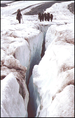

    b. Dangers and Obstacles. The principle dangers and obstacles to movement in glacial areas are crevasses, icefalls, and ice avalanches. Snow-covered crevasses make movement on a glacier extremely treacherous. In winter, when visibility is poor, the difficulty of recognizing them is increased. Toward the end of the summer, crevasses are widest and covered by the least snow. Crossing snow bridges constitutes the greatest potential danger in movement over glaciers in the summer. On the steep pitch of a glacier, ice flowing over irregularities and cliffs in the underlying valley floor cause the ice to break up into ice blocks and towers, criss-crossed with crevasses. This jumbled cliff of ice is known as an icefall. Icefalls present a major obstacle to safe movement of troops on glaciers.
    (1) Moving on glaciers brings about the hazard of falling into a crevasse. Although the crevasses are visible in the ablation zone in the summer (Figure 10-23), the accumulation zone will still have hidden crevasses. The risk of traveling in the accumulation zone can be managed to an acceptable level when ropes are used for connecting the team members (Figure 10-24). Crampons and an ice ax are all that is required to safely travel in the ablation zone in the summer.
    Figure 10-23. Ablation zone of glacier in summer.

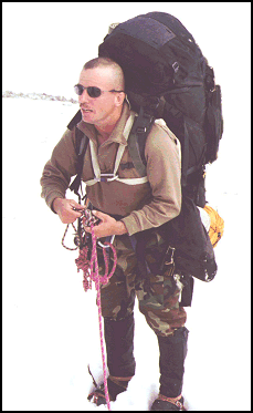

    c. Roped Movement. The first rule for movement on glaciers is to rope up (Figure 10-25). A roped team of two, while ideal for rock climbing, is at a disadvantage on a snow-covered glacier. The best combination is a three-man rope team. Generally, the rope team members will move at the same time with the rope fully extended and reasonably tight between individuals, their security being the team arrest. If an individual should break through a snow bridge and fall into a crevasse, the other members immediately perform self-arrest, halting the fall. At points of obvious weakness in the snow bridges, the members may decide to belay each other across the crevasse using one of the established belay techniques.
    Figure 10-25. Preparations for roped movement.

    d. Use of Prusik Knots. Prusik knots are attached to the climbing rope for all glacier travel. The Prusiks are used as a self-belay technique to maintain a tight rope between individuals, to anchor the climbing rope for crevasse rescue, and for self-rescue in a crevasse fall. The Prusik slings are made from the 7-millimeter by 6-foot and 7-millimeter by 12-foot ropes. The ends of the ropes are tied together, forming endless loops or slings, with double fisherman's knots. Form the Prusik knot on the rope in front of the climber. An overhand knot can be tied into the sling just below the Prusik to keep equal tension on all the Prusik wraps. Attach this sling to the locking carabiner at the tie in point on the harness.
    Note: An ascender can replace a Prusik sling in most situations. However, the weight of an ascender hanging on the rope during movement will become annoying, and it could be stepped on during movement and or climbing.
