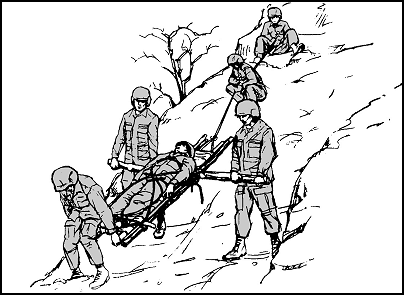

c. Descending Slopes. When descending a moderately steep slope that can be down-climbed, the litter and victim are prepared as described earlier (Figure 11-4).
(1) One man serves as the belay man and another takes his position on the rope in front of the belay man, assisting him in lowering the litter. The litter bearers take their positions and move the litter down with the speed of descent controlled by the belay man.
Figure 11-4. Low-angle evacuation - descending.
(2) The extra man may assist with the litter or precede the team to select a trail, clearing away shrubs and vines. He reconnoiters so that the team need not retrace its steps if a cliff is encountered.
(3) The most direct, practical passage should be taken utilizing available natural anchors as belay positions.
