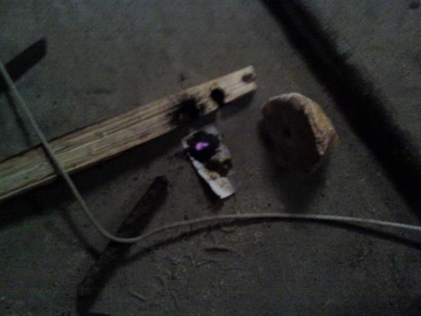

P.S. I actually found a "socket rock" in a dry stream bed, while on one of my
"expeditions".
Has a perfect hole in it and if you put it in your hand it fits perfectly.
Here's a couple of the pic's of the bow drill "socket" I found.
