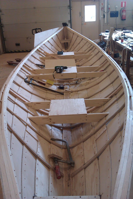

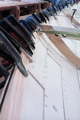

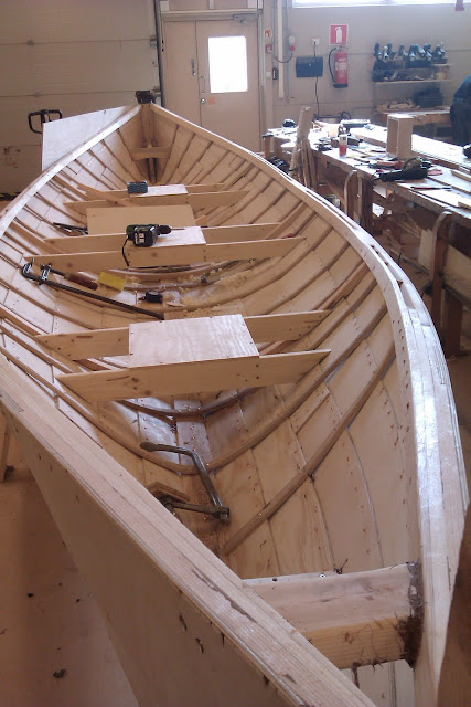

Those are where the boat is now. We have scraped all extra fill otc the plank seams and begun to attach more stuff...

Further update on Ursula.
https://lh3.googleusercontent.com/_Z...4/IMAG0500.jpg
https://lh3.googleusercontent.com/_Z...0/IMAG0499.jpghttps://lh3.googleusercontent.com/_Z...0/IMAG0497.jpghttps://lh6.googleusercontent.com/_Z...4/IMAG0509.jpghttps://lh3.googleusercontent.com/_Z...0/IMAG0508.jpghttps://lh3.googleusercontent.com/_Z...0/IMAG0507.jpg

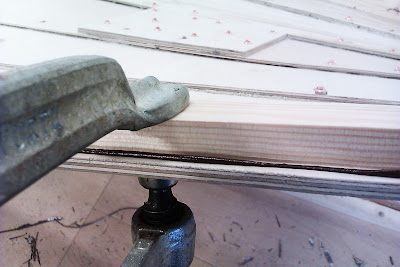

Today we prepared and made two of the three stiff ribs. The third one will be my exam to judge my level of skill with basic wood working. The ribs are formed of three 10mm thick, 40mm wide and from 170mm to 185mm long pieces of knot free pine strips.

My Exam, the third stiff rid has suffered a little setback for reasons not under my control. It was going alright, I did everything according to safety regulations and so on to the point of perfection. I managed to pick good quality wood for the project, the laminating process didn't have any issues and finishing the piece went well also. Then started the fitting. The piece was just the right size and all I needed to do was to carve spaces for two slap joints and the gunwale on the rib to make it perfect. As soon as I started making the first slap joint embedding slot on the rib the first laminated layer snapped loose like a leaf spring. I examined the glue seam and it turned out it hadn't set properly. I begun to wonder why. I was certain that the hardener ratio was correct and I had had it on suitable clench. Soon it hit me, it was colder than usual INSIDE the workshop. Only +12C(53.6F) when normal temp is around 18C(64.4F). It was too cold for the glue to set!!! The heating had partially broken down due to the -40C(-40F) night temps on few consecutive nights and -30C(-22F) days... It would appear that my exam is slightly delayed due to weather issues. The temp should rise to around -20C(-4F) this week, so hopefully I can get the project moving soon.

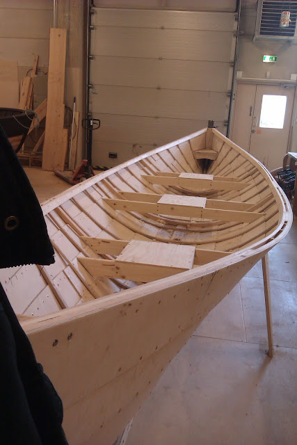

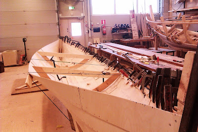

Another update, after a short course of fiberglass repairs and laminating I got back to Ursula, and now we have both gunwales finished and we have begun to work with the interior.

It looks like another boat in progress on the other side of the bench. It looks like a different design. What is it?

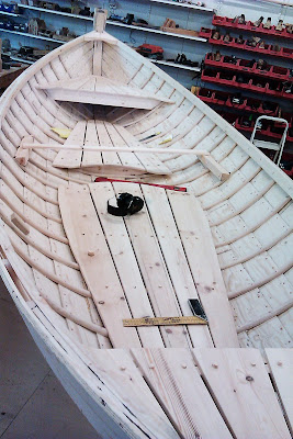

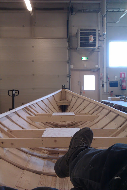

It was a short working day today due some theory lessons on glues. I stayed after school to take pictures for you!! :yes:
Note, most pictures are taken from bow towards stern. In the picture taken from the side the bow is on the right.

Rick, there is total of five boats under construction or repair in that space, the one you asked of is a project that one of our student's is building for himself. It is an old western Finland fishing boat design, originally a sail boat but later they usually had a middle engine.
The launch date of Ursula is "before midsummer"(of undisclosed year). I doubt I'll get a chance to get a picture of her in the water let alone row her, she was ordered by one of the teachers from the metal department(?).
I think you and the others should at least do a Sea Trial to make sure she is seaworthy and of sound build. (There has to be a rule somewhere!)
Might, with luck get to do sea trials... Hopefully... It's a well known design though and the teachers have kept an eye on us building it.

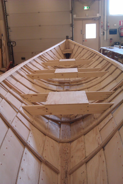

We have the interior works now mostly done, so more pictures coming your way!
These two were taken earlier while there still was some interior work to be done.
https://lh6.googleusercontent.com/_Z...0/IMAG0782.jpg
https://lh5.googleusercontent.com/_Z...0/IMAG0783.jpg
And these were taken after days work, today.
https://lh5.googleusercontent.com/_Z...2/IMAG0810.jpg
https://lh4.googleusercontent.com/_Z...0/IMAG0808.jpg
https://lh6.googleusercontent.com/_Z...0/IMAG0809.jpghttps://lh5.googleusercontent.com/_Z...0/IMAG0811.jpg
We certainly are getting there.

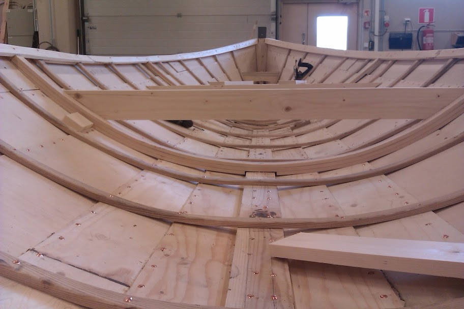

You are doing a great job on it. It looks like copper fasteners are being used throughout the boat. Is that correct? While copper won't rust it will corrode. Is that a concern with salt water? I assume that's pretty traditional as well?
Yeah, the copper rivets are used throughout the boat, though with the benches and other similar structures where it is very difficult to rivet anything we use stainless steel screws. The salt water is not really an issue since the boat is made for lake use. Also the tar, or what ever the teacher say we paint it with will protect the rivets. From what I have seen from the repair projects we have is that the rivets are the last thing to fail. The Sikaflex-291 boat sealant we use as a caulking material rots away before the rivets do, and the 291 does last a long time.
