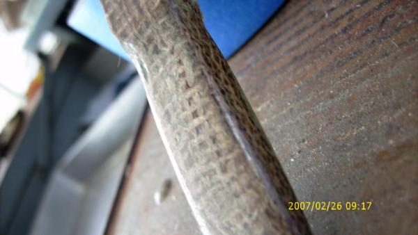

I wonder if you could use a heavy cordura or an old pair of carhart overalls for scales if the denim works, will have to see what these turn out to look like first. Thanks for the update and photos.
You can use denim, canvas, linen, and there is also paper micarta. Here is a pic of some made from burlap. It was made by a fella knifemaker in Texas.
[IMG]http://www.wilderness-survival.net/f...&pictureid=879[/IMG]
