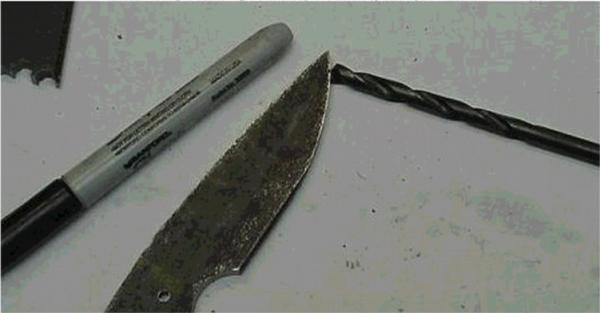

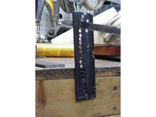

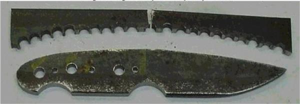

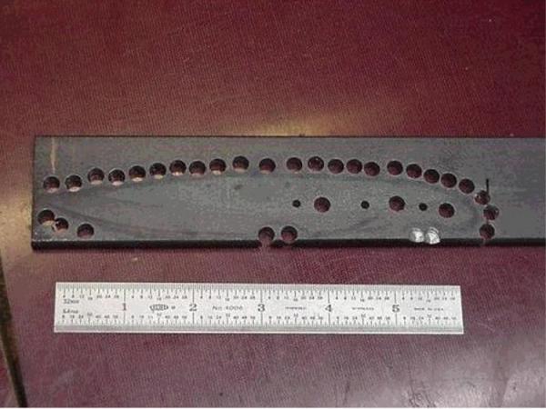

First pic is the shape of blade drawn with a marker. I used a 1/4 drill bit and drilled around the profile. It takes a lot of the hacksaw work out of it and makes the curves easier to cut.
http://www.wilderness-survival.net/f...&pictureid=904

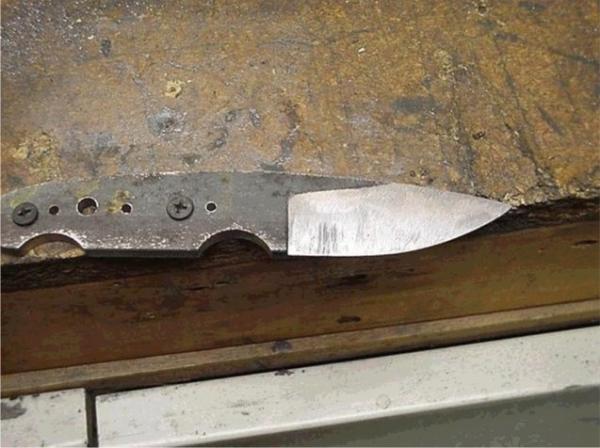

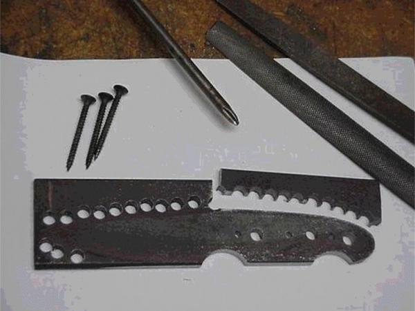

Screw the blade to a bench or stump or whatever you have and cut out the handle portion only. If you have a vice or clamp by all means use them. Remove the material so you can file the handle to shape. Do this first because you won't have any way to screw the blade to the bench if you cut out the entire blade. do the handle work first! Once the handle is to a pretty good shape remove and screw to the bench through the handle and cut out blade.
http://www.wilderness-survival.net/f...&pictureid=905
Ok I forgot to add the 1/4 inch drill bit to the list so add it.

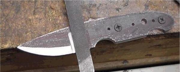

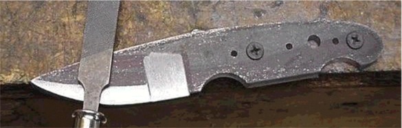

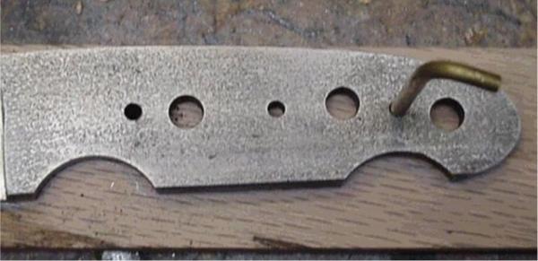

I drilled all around the profile of the blade. This really makes it easy to use the haksaw to cut out the profile. I just unscrewed from the bench and repositioned as need to cut off the excess for the handle. I drilled the 1/8" holes for the pins in the handle and the 1/4" holes in the handle to allow me to screw to the bench to work on the blade ortion. I have the handle filed and added a couple of finger grooves for the heck of it. I am ready to saw the business end now and file the rest of the profile. Next I will file the bevels. Be patient it takes time with the files.
