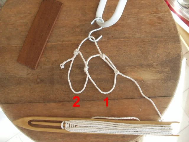

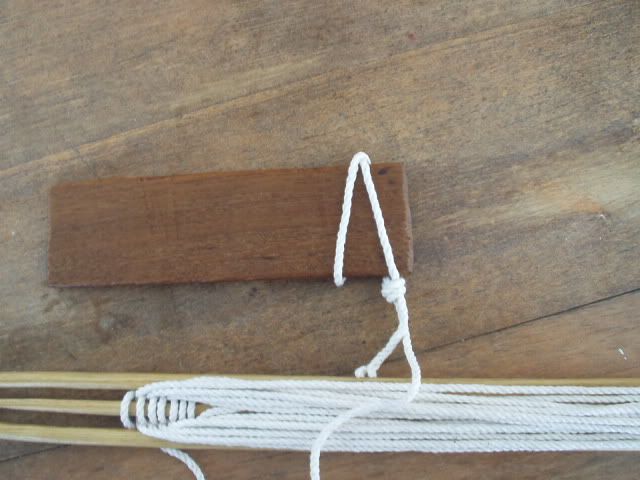

Tie two meshes into a support loop. Leave a short tail (on left) to finish net.
http://i.imgur.com/zyfhL42.jpg

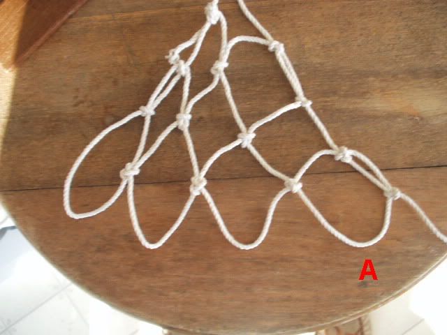

In the following rows tie into each mesh of the previous row until the desired width is met (measured from A to B)
http://i.imgur.com/akREhfF.jpg

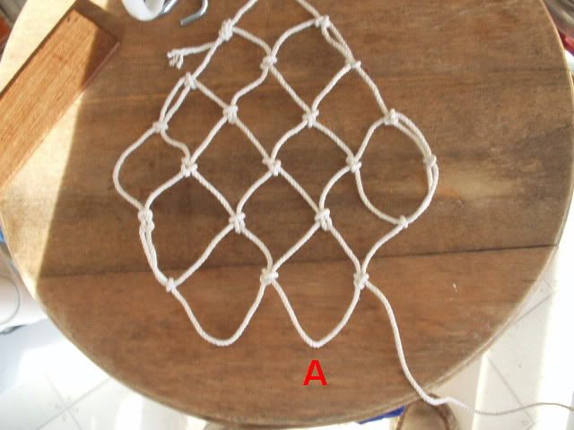

When you get to the desired length - see A previous row tie two meshes together at the end of each row.
http://i.imgur.com/ziHGwMH.jpg
http://i.imgur.com/WyJHwsB.jpg
http://i.imgur.com/M207CkM.jpg

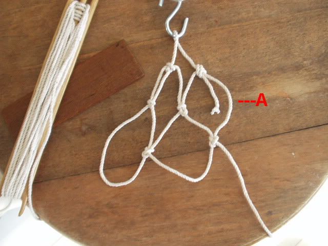

1. Place cord twice around gauge and tie overhand loop.
http://i2.photobucket.com/albums/y18...utorial001.jpg
2. Position overhand knot halfway up the loop and tie into bottom loop. This is the beginning of the chain start.
http://i2.photobucket.com/albums/y18...utorial002.jpg

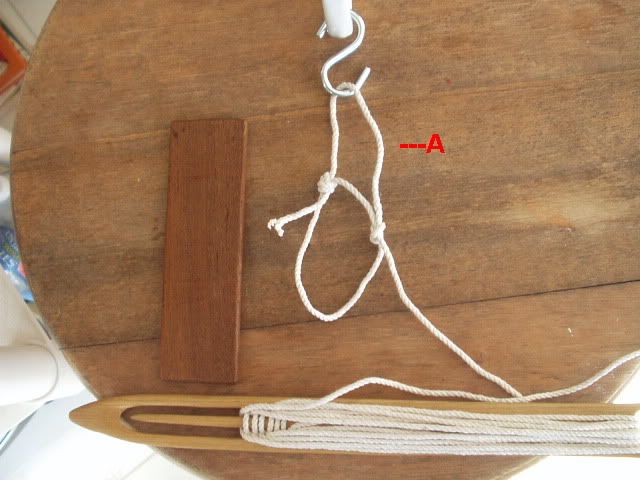

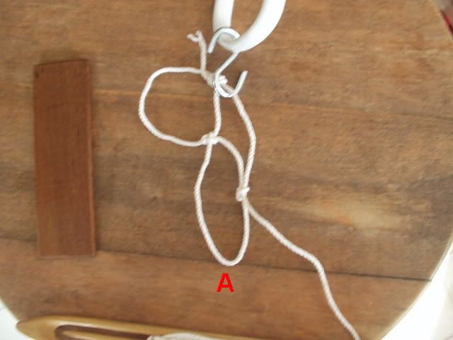

3. Tie into A (above photo). Notice that support position for the net has shifted to left. See photo below.
http://i2.photobucket.com/albums/y18...utorial003.jpg
4. Tie Half Hitch at botttom of mesh (A - above photo) and then reposition net so that support is at top. It should now look like below photo.
http://i2.photobucket.com/albums/y18...utorial004.jpg

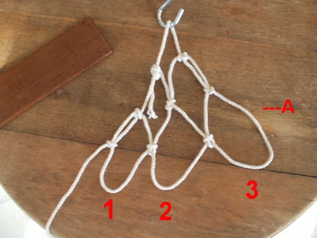

5. Tie into meshes 1 and 2 above (after flipping the net so you tie left to right) Should now look like photo below.
http://i2.photobucket.com/albums/y18...utorial005.jpg

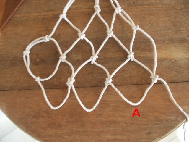

7. Now tie into meshes 1,2 and 3 and side mesh A (above photo). Tie half hitch as before. Should now look like photo below.
8. Shift position so that support is at top and tie another half hitch at bottom of mesh (A - below photo). We are beginning to close net.
http://i2.photobucket.com/albums/y18...utorial007.jpg

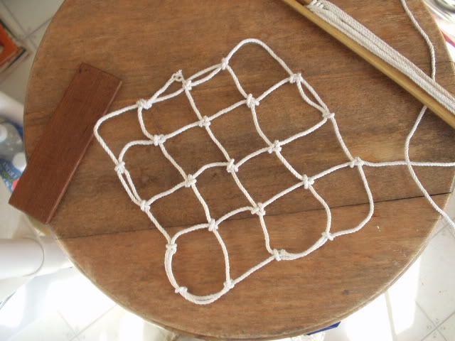

11. Tie half hitch at A and then into single mesh to complete net.
http://i2.photobucket.com/albums/y18...utorial010.jpg
