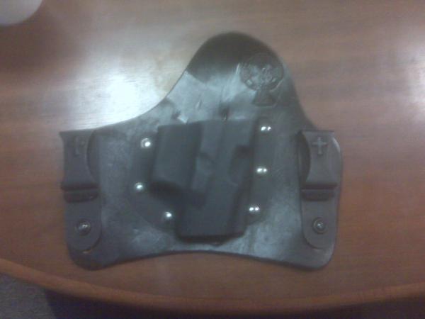

Doug you could probably make some of these. A guy I know uses it for concealed carry. With your shirt tucked in you can only see the two clips. I am going to order some popular pistol profiles one of these day and make a few. He says he paid 80 buck at a gun show for this one. The back is leather btw.
http://www.wilderness-survival.net/f...pictureid=2021
